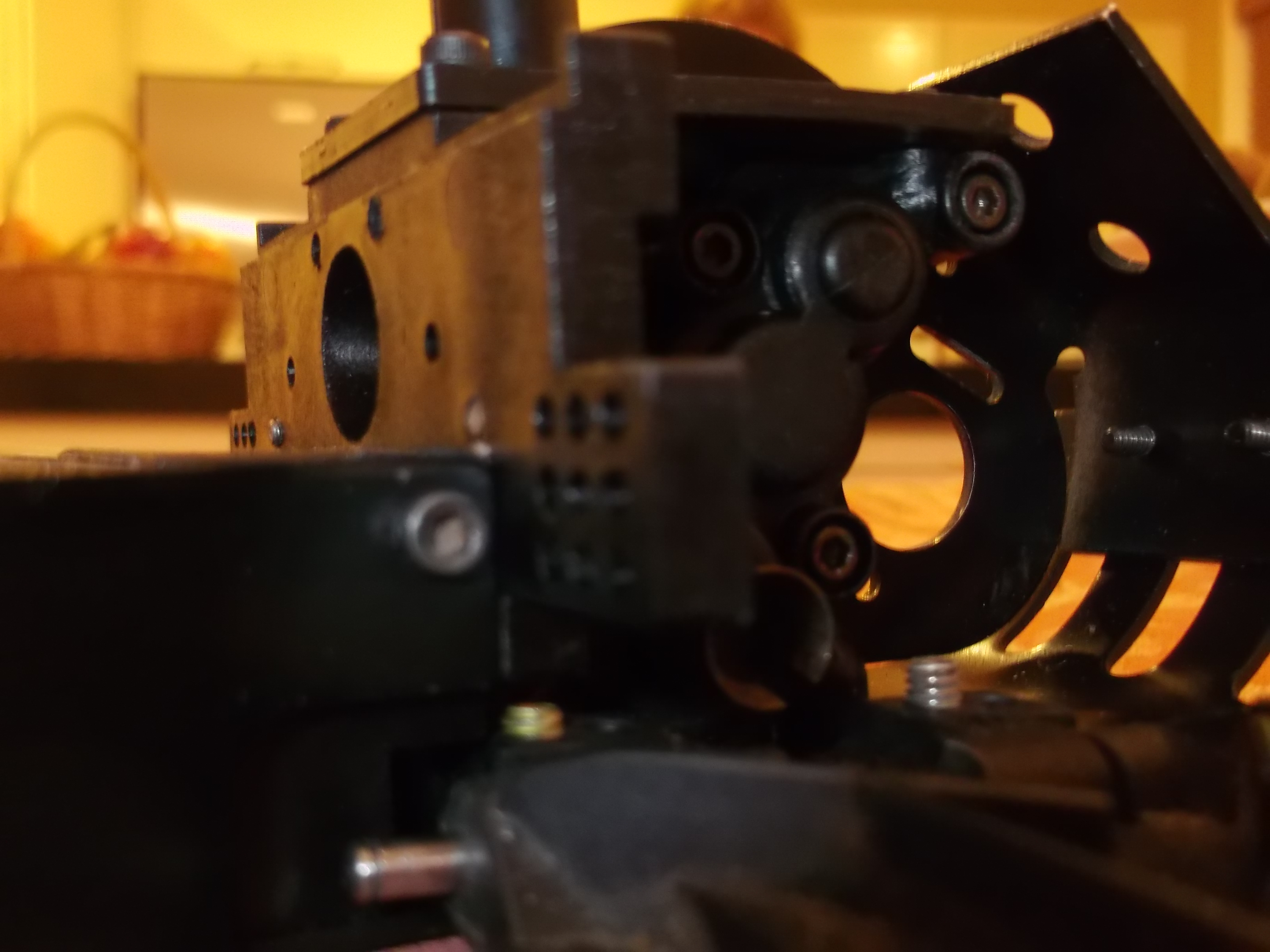

I've had this chassis for a while-it's a black Team Car chassis, but it's stamped with an 'A'.
My other Team Car shelfer is stamped with both an 'A' and a 'B'.
Both chassis were pretty scratched up, so I had to resort to repairing the damage and painting them, bit of a bummer, but they look great.
I'm going all modern with this new Team Car build-RPM arms, CVDs, yellow B4 wheels, yellow A&L steering, B4 threaded shocks, a Castle Mamba Pro ESC and Orion brushless motor.
And it's going to be all black, with a few yellow parts to break the black up.
Here's the shelfer...
I already bought the regular RIT powdered dye, I hope that'll work out OK.

Thanks for all the info, the parts turned out great!
The Andy's front arms were the mankiest, yellowest, most unusable arms, ever and now they're killer.
Same with the re-re bulkhead and tranny case.
