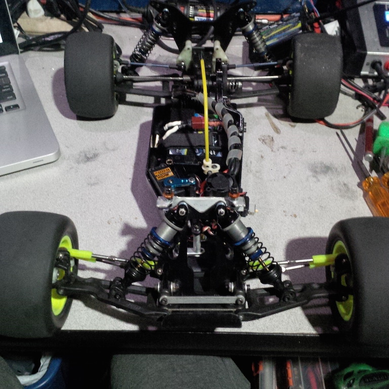

So after seeing a few of the mid motor buggy's posted on here I decided I wanted to convert mine to mid and maybe run it in the stock class that was suppose to be starting in my area. So I had some 3mm G10 to use and so I got started.
I traced my tub for shape and hole location. Once traced I started mocking how this might work. The chassis shape allowed for three different battery configs.
After the local stock class never materialized I decided to convert my stadium truck instead. With the high bite track here I always struggled to keep the front end down when running the truck in mod, so I thought mid motor might help. So as I started fabrication I had to get a few parts. Big thanks to nix for creating and making available the waterfall brace and the gear cover; also picked up a Robinson Racing Tracker rear arm mount. I went with tracker arm mount because the new ones don't seem to be 1.5 deg and break easily. Below is the result. Made some mistakes with hole placement and countersinking but overall I think it came out pretty well. Ran it a little on the street but can't wait to get it on the track.

Thanks guys. Yeah I don't dig the GT conversions either. Seems like you would have a hard time balancing the truck left right with that layout. Also I think the electric conversion seems to move the motor a little to far forward which would in my opinion hurt the rear traction a little to much. I did screw up drilling the rear holes for the tracker because my original intention was to shave down the rear bulkhead down and mount it on some blocks I made for the arm mount. The problem was I drilled the holes to narrow to mount the bulkhead; so I had to mount it behind the mounts. Because of that I had to scramble and make a mount for the rear camber link, it's not pretty but works. I did leave some space in the middle of the chassis to add a stiffener if I find the chassis to soft. Still haven't run it yet, hopefully I will get to run it this week some time.

The shocks are PR Racing/HobbyPro USA. I run their 2wd and 4wd buggies, and had an extra set so I threw those on there to test. The rears are a little shorter than stock but most run a limiter in the rear anyways so it shouldn't be an issue.8rad wrote:That looks like a great conversion.

I finally got to take the 10T1M for a spin last night. I must say it drove really quite well. Still had plenty of forward bite but really rotated well. I definitely need to work on the shock package; the truck was bottoming out way to easily. For a first outing and my first attempt at a custom chassis I really happy.

I did. It wasn't installed in those pics because I needed to thin out the bottom screw area to clear the RRP rear arm mount, and hadn't done that yet. I have it on there now, and its great. I love that it's rigid and gives a little extra strength to the motor mount that has a tendency to bend (at least in rear motor).

Nice to know I can run the VTS slipper, but I probably stick with the T3 one I'm running now.
As for the rear bulkhead I don't have any plans right now to move it. Due to my screw up with the rear arm mount holes, I would have to redo the whole chassis if I wanted to do my original plan of mounting it on top of the RRP rear mount.

I made it to an indoor track for some practice today, and I'm pretty happy with the way it drove. Still need to work on the shock package a little more, but it was better today. There is a sporadic clicking and slight binding in the drive train that formed towards the end of the day I have to figure out; hopefully it isn't anything to major. It was hot today 90+ so the slipper was getting a workout and I was having to play with the settings to find the happy middle. So even in mid it can do a wheelie when the slipper is to tight as you will see.

As an update, I have converted it to hex wheels mainly due to wheel availability and it was fairly cheap to do.
I ran it a race last weekend and qualified 2nd. It was pretty hooked up compared to the other trucks, traction was limited, but the 10T1M still worked well. I think it had to do with the g10 chassis's extra flex. I did bend a cvd bone which in turn caused a chipped outdrive. because of that I had to eliminate almost all the droop in the rear just race the main. The lack of rear droop really affected the jumping but was able to finish 3rd; could have done better had the driver held it together. So I guess I'm going to have to order new cvds and out drives .
