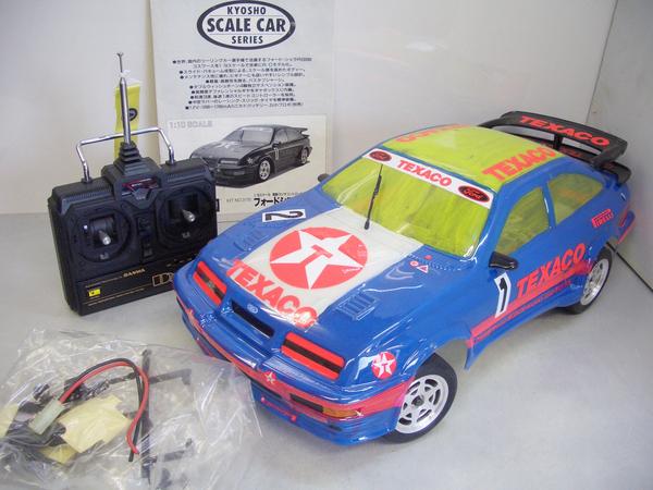

A few months ago I bought a Kyosho Ford RS500 based on the Raider chassis. In the future (next year) I want to complete this project, as I've finally obtained some electronics that look suitable for this car (even though they're about a decade too young...) - if they work.
Here's the pic from the sale:
The body has been mostly stripped by now; the paint used was dissolvable in alcohol, but getting it all off is difficult. Some of the stickers are damaged, with paint having gone under the stickers (GRRR ).
