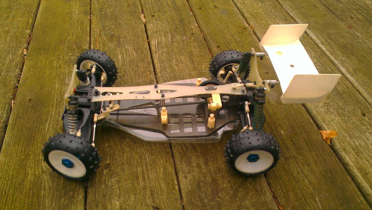

First one below is a '94 that appears to be mostly stock, with the exception of a TCS unit and some slots cut in the lower deck to accomodate the velcro battery straps. Despite it looking a bit dirty, on closer inspection the parts are all in very good condition...belts, diffs, etc. Very low wear, although the philips screws are shot and I'll need to replace with some hex screws. Although not shown here, this one also came with a Pavidis body, another set of used wheels, and a set of NIP LRP BBS style white wheels. This should give me one relaxing weekend of cleaning and massaging. Haven't decided yet if it'll be a runner or a shelfer. Probably the latter, since I already have a '94 runner.

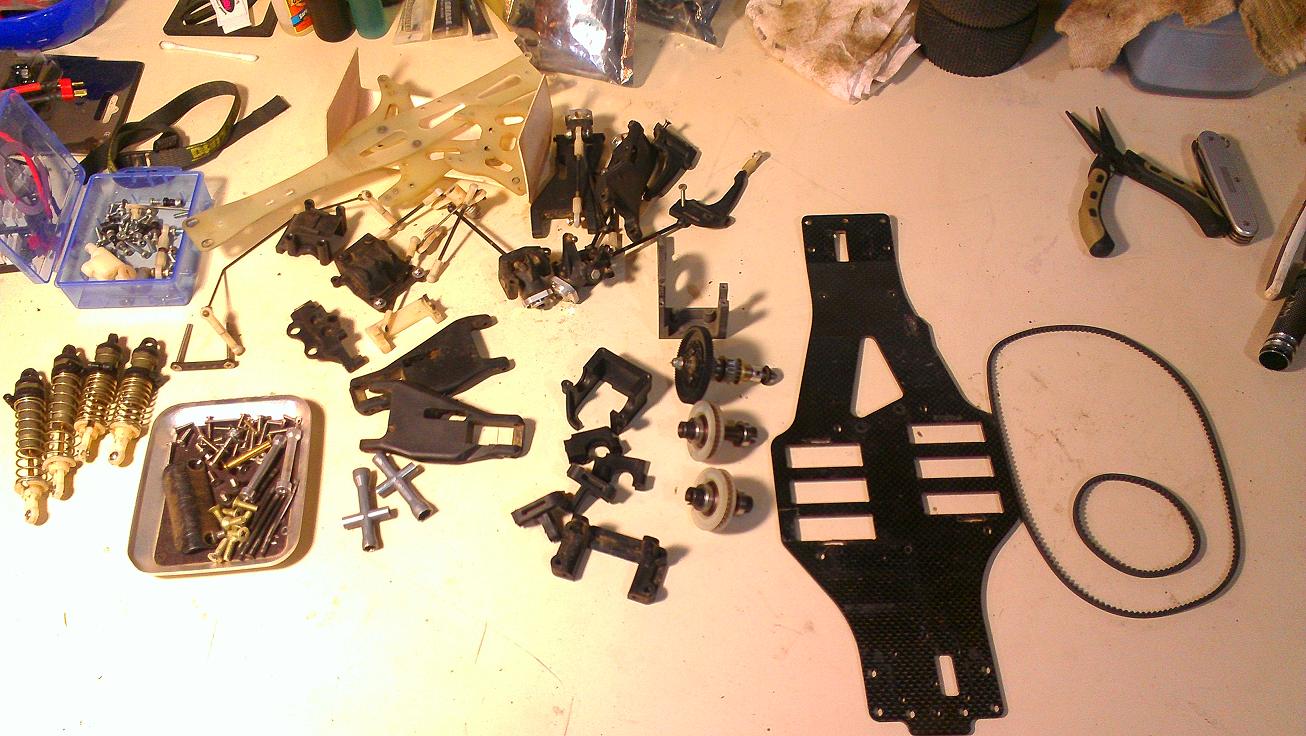

I spent an hour or two tearing this thing up for closer inspection and [eventual] cleaning. Overall, most of the parts are in pretty good condition and just need some cleaning. The aluminum center pulleys are showing some signs of wear, but I'm not surprised considering how aluminum is relatively soft. No big deal...
One of the front inner hinge pins (bottom picture) was bent pretty badly and it took some fiddling to pull that one out of the bulkhead. This car must have taken a pretty hard knock, but intererestingly, it is only the hinge pin that is bent. There is not a single sign of corresponding damage on the bulkhead. This is one tough cookie!
The lower deck definitely took a dive off of the ugly tree, however. There is some heavy gouging near where the servo was mounted, plus the slots I mentioned earlier to accomodate those battery straps. I'll hang onto this one as a spare and get a new one from Fibre-Lyte, and then make my own lipo tray as per my other '94.
Might be a little while until I get the new lower deck, so the car will stay in this torn down state for some time. I want to put hex screws all around on this and some proper titanium turnbuckles. I don't think it "needs" anything other than that, but we'll see as the rebuild progresses...

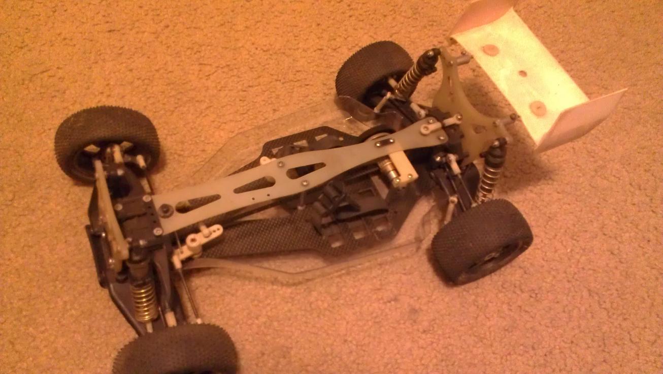

Pretty much done now. Cleaned everything up and added hex screws almost everywhere. I used Simple Green and a rag to clean the fiberglass parts, and it came out pretty nice. (**edit** I cleaned every part with Simple Green, just to be clear) I also tried WD40, but did not notice any real difference. I also put fresh o-rings behing the shock towers and installed Suzuki wheel hubs. Also replaced the springs with AE silver/green springs front/rear. They are smaller diameter than the Yokomo springs, but you can force them to fit onto the spring cups. I have a '95 body that came with it that needs painting. I have the pattern figured out (I'm a flames guy)...just need to wash it, tape it, and paint it. Considering that this was my "cheapest" '94 YZ10, I'm quite happy with how it came out after a little TLC.
The only thing missing here are the battery straps. I made a recent order from Fibre-Lyte for other YZ10 stuff, but forgot to add that to the list. I would like fiberglass ones for this, though, which means I'd probably have to make them myself out of G10; however, I have yet to find any G10 sheets where the shipping costs less than the sheet itself, and I do not know of any local suppliers. If anybody knows where I can pick one up, some info would be appreciated.
