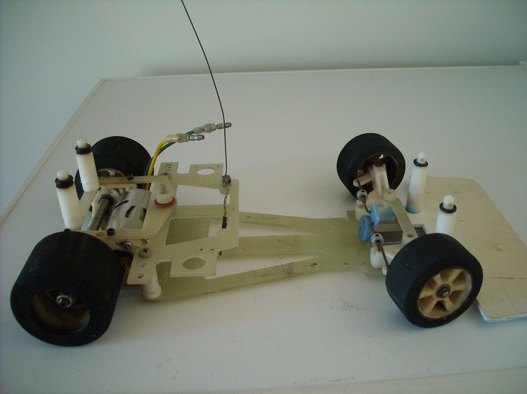

A quick question -
The first 1/12th onroad I drove seems to be an I model. I´ve purchased this one from memory, but I remember the radiodeck to be longer. Did someone cut the radiodeck or did it come in this variant aswell?

The one in Your picture looks very opmized - is it all ae parts?
Is it still possible to find a topdeck or will I have to mount the battery on the chassis?

I believe you have an RC12e bumper which is much bigger than the RC12i bumper and you will need 2 standoffs for the correct top deck and appropriate screws top and bottom. This is what the front end needs to be original.

Isnt that an early car? Looks like it has the front end cutouts and no spring front arms. If that's the case, it doesn't need the front standoffs (although they do help for a runner). Not sure on the big bumper, I thought all 12i's had the small one as mentioned above. If you can't find an original, reign79 makes reproductions that look great! My upper decks are all newer gen that use the front standoffs but they seem to be hard to find
