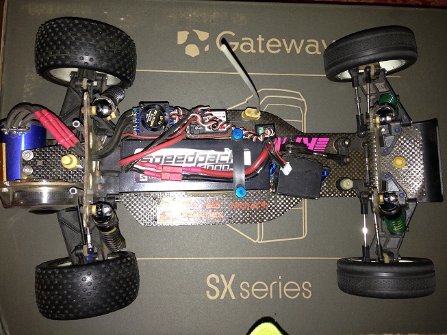

hi there to all you rc freaks!
this is my old RC10 I bring it to live again with all the new tech hope you like it!
lipo 4000
brushless motor 10.5
esc 350 amp burst
new mip axle with boot cover
rpm rear carrier with b4 shaft to run new tires 2.2
rebuilt all shocks
new shock shaft frt gold ones
tc3 holding batteries nut with treat
rpm bumper frt
titanium turnbuckle
serpent tie rod end in steering
green spring frt
black spring rear
losi 2.2 x1.50 rear tire
proline frt tires 1.125x3.25 wide
rpm steering system
new transmission outdrive both sizes
trans rebuilt new bearings
new wing
this ting run like rocket even with the slipper clutch a little loose to allow some slip . :mrgreen:

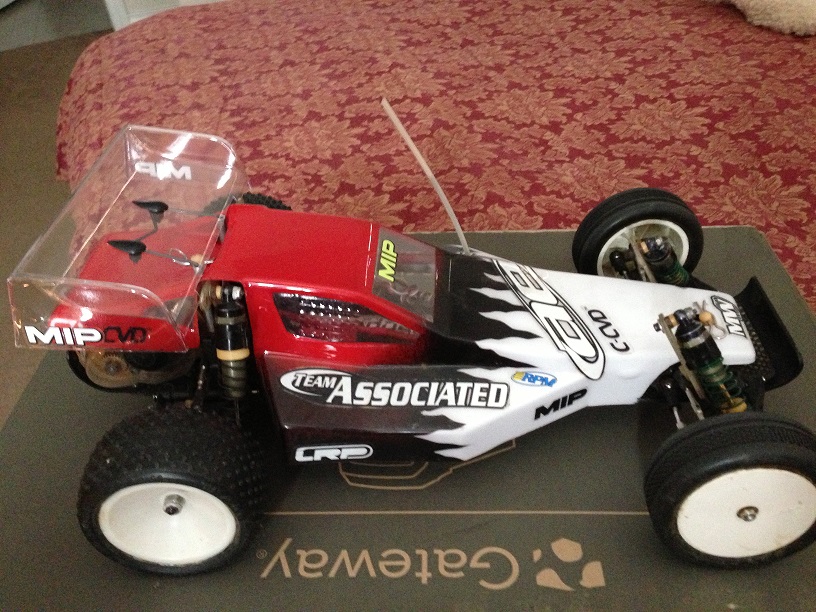

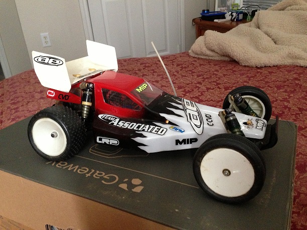

Welcome... it looks great... what body is that?

uniquenamehere wrote:what body is that?
Looks like a Viper

Yup Viper body for sure. Nice build!

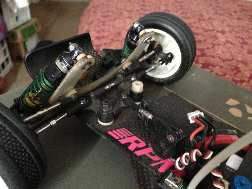

Mind snapping a pic of the front battery tray? Curious how you got your LiPo to fit.

Really I don't have the name of the body.
about the fitting of the lipo is easy just cut the front part of the battery holder and you just holded with some treet nut like the one for TC3.
look the old wing frm ASSOCIATED
any other idea to share with my ... im planning to move to a JR racing servo

Assuming the old transmission is handling the 10.5 ok?

no problem whatsoever the trick is allow the clutch to spin a little bit and reprogram the ESC to have like 20% brake .. for me is enough brake.
