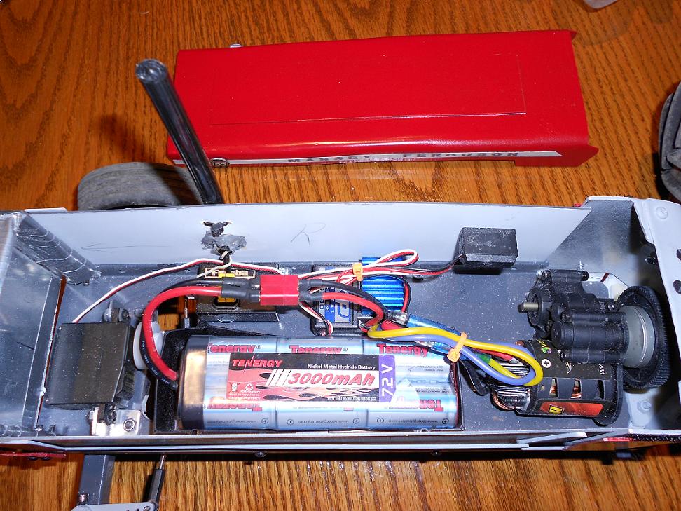

Here's my final RC project...A 1966 Massey Ferguson 165 ag tractor. It's entirely hand-built using a dremel, with metal from K&S and the local hardware store. The front axles and steering linkage are from DuBro. The hood is styrene plastic, and I used a gearbox and rear end from an Axial crawler. The motor is a Venom 50-turn crawler, with an Associated ESC and Futaba radio gear....It runs about 6-8 mph (it's a tractor, what do you expect?), but it can climb a wall. I figure it was a fitting end to my RC hobby, since I sell parts for the REAL ones. (Maybe someday, I'll consider restoring another RC10.)...Enjoy!!

The driveshaft is slightly angled to line up with the rear end. The yokes are steel, with set screws on both sides. It's too much of a pain to take apart (I hope I never have to). The antenna runs up through the stack.Coelacanth: I think I need to find a "Daisy Duke" doll to fit...I'll check Walmart this weekend.
