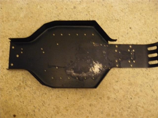

4) I have the aluminum parts all cleaned up but due to a bad cell(s) some of the anodizing got messed up, besides a sharpie on the easy side and re-anodizing on the difficult side is there a mid-ground that will look good? (pics below)
5) When using chassis protector film do you ideally put it on before assembly and run the screws through it or would you put it after and cover the screws as well as the entire bottom of the pan?
Best way to correct this?

As for the chassis, I wouldn't bother with the sharpie fix. It'll
never match and it'll stick out like a sore thumb. If you want it to look factory original, you're better off reannodizing or replacing it altogether. If you're not worried about looking stock, get one or two of the largest sheets of carbon fiber decal material you can find and cover the whole thing up. ;)

Personally, I wouldn't worry about the blemish on the inside of the tub if you plan on running it. Do your best to stick the Esc over the spot and put a body on her and you'll never notice it. (Or find a large decal to slap over it) On a good note, the underside of the chassis is near perfect. :)
