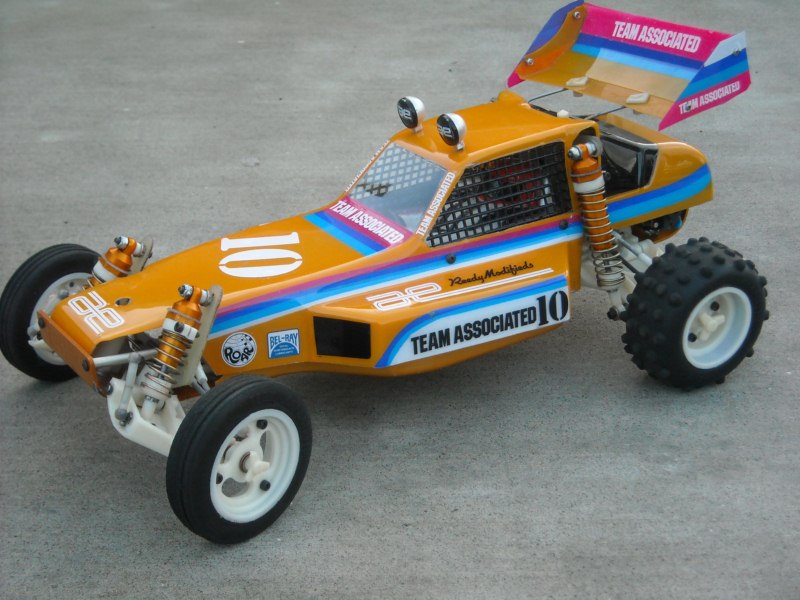

Here is what I used, all rattlle cans. Check the buggy forum under Readers rides or do a search under box art and you will find some photos of my car.
OK here are the spray cans I used on this one:
Tamiya PS-19 Camel Yellow main body
Tamiya PS-33 Cherry Red accent stripe
Pactra RC252 Blue Streak accent stripe
Tamiya PS-3 Light Blue accent stripe
Pactra RC251 Sprint White accent stripe
All colors were backed with silver to prevent bleed thru. Overall I'm very happy with how it came out, only mistake was I messed up on the rear wing and put the pink on the bottom instead of the top. Will eventually correct this when I find a correct wing

Re: Paint codes for Rc10 box art?
so that camel yellow is pretty much orange, or did you blend it? If you didn't, man, that is sooo close it's gotta be what was used for the boxart..
That is straight out of the spray can. I thought it was just about a perfect match.

Beautiful work. I am a noob when it comes to paint. That's why I paid a small fortune for my body.

When you say backed with silver, does that just mean after you spray on a few thin coats of the colour you then spray it with a thin (or thick?) coat of silver as well?DougH wrote:Here is what I used, all rattlle cans. Check the buggy forum under Readers rides or do a search under box art and you will find some photos of my car.
Any silver in particular you would recommend?

When you "back" a color. You are just painting a thin coat behind the first color you painted.
I use Tamiya cans exclusively. I found their lexan paint to be superior many years ago.

And is there any purpose in doing that if I were to only paint the orange and use decals for the rest?SMOKE-DOG wrote:When you "back" a color. You are just painting a thin coat behind the first color you painted.
- Posts: 11333
- Has thanked: 823 times
- Been thanked: 2419 times
It keeps the paint from being opaque. If you only put orange on it you will probably be able to see thru the paint a bit. Backing it also gives you a chance to change the color slightly. Backing with silver, white, gold etc will all show thru a bit differently
