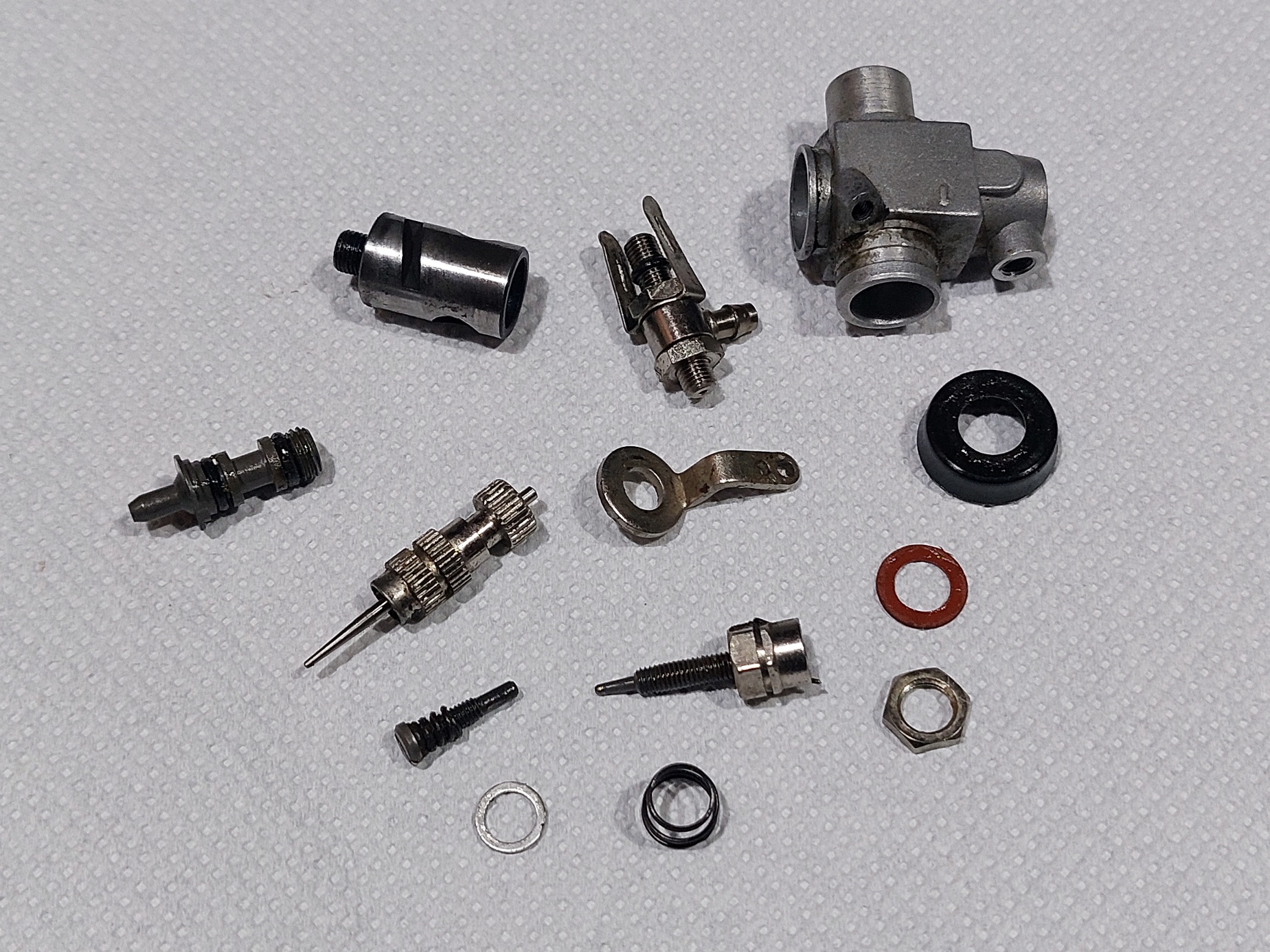

Carb all pulled down, nothing looked too bad here, just dirty
