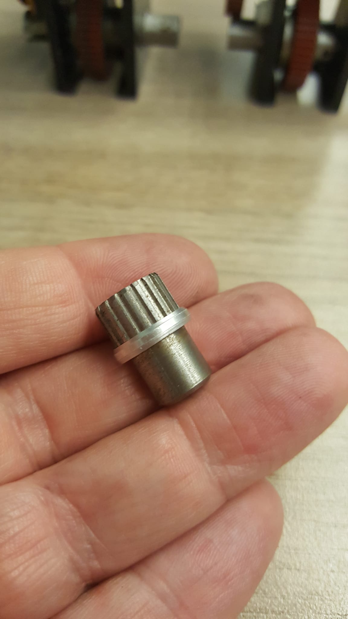

On a couple of these it seems a little odd that the intermediate gear is only supported on one side of the gearbox. However, having stumbled across a spare short spindle shaft in the box of spares which came with these I can now see that a little thought was put into this; it isn't just a simple straight shaft. The threaded portions extended through the gearbox casing and the stepped section is then locked down hard onto the inside of the case by tightening down an external nut. Once this is locked down hard there is absolutely zero movement of the shaft whatsoever. Then a brass intermediate gear complete with ballraces is slipped over the shaft on the inside and is secured with a C-clip. An interesting design, but it does appear to work well.

That's better supported than the idle gears in a six gear.
