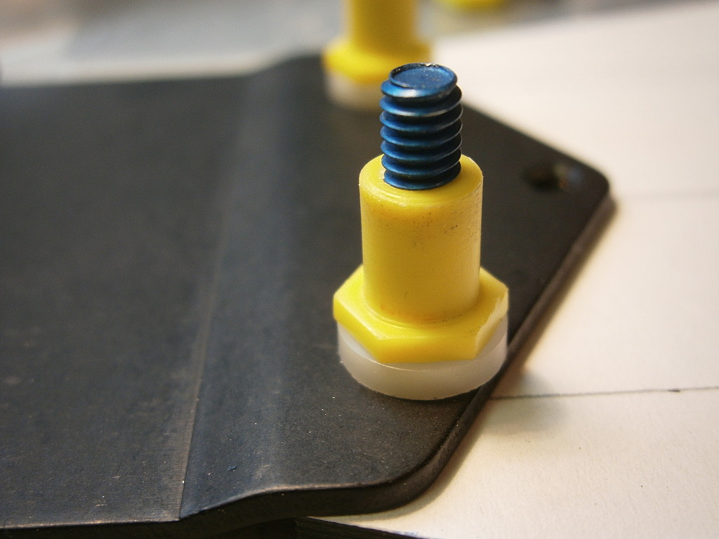

I got the bellcranks from Jeff, along with a bunch of other cool stuff. Here is what I've done with them so far...
First up, I made some nylon washers to go underneath the posts. I wanted them to fit better than a steel/aluminum washer. They are 0.075" thick. This allows the plain nut on the ball stud to have 1mm clearance on the nose plate.

I didn’t think to mention it but we sometimes use the yellow nuts as spacers under the posts. It’s a tricky fit on an rc10, there is a lot of front suspension in the way of the steering assembly. Looking good so far I’m hoping to cut some more delrin parts soon.
