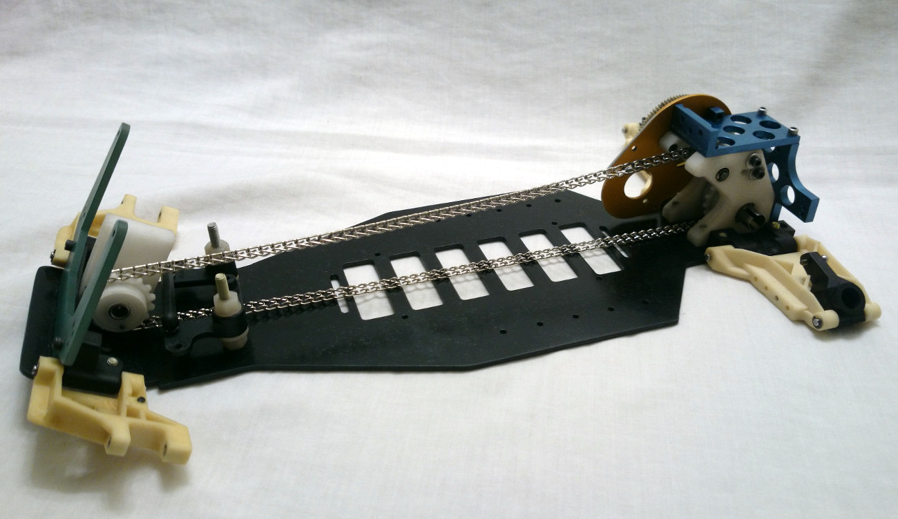

Just a teaser/proof of concept pic for now since I finally picked up a chain and the project actually looks like something tangible. :P
TPS transmission is custom made out of delrin...parts have all been mirrored so that it can be used mid-motor. At the front is a TPS sprocket with homemade bearing holders to convert it into a one-way. The delrin block that the front sprocket is attached to is only a mock-up right now, to get the positioning correct. It is attached to the kick-up using the inside front arm mount holes...which are freed up by using an RPM one piece front bulkhead mounted in reverse. I'll eventualy chop the top off the front transmission halves and use them as the front mounting points of a top deck.
Not sure if I'm going to keep the car built on the ARP chassis or cut a G10 one with an aluminum front kick-up. If I do change chassis I will lower the kick-up angle and narrow up the front end to use wide front arms.

The chain clears around the motor?

shodog wrote:The chain clears around the motor?
It clears but the chain does get magnatized to the motor if it's too loose. :wink:

Thats a pretty wicked prototype, looks awesome. There is an optima build blog that the guy drove the rear on a chain and used a suspension pivot ball as a guide, came to mind as a way to keep chain off the motor or as a tensioner. heres the link

That's a pretty neat Optima. I was going to put a mono-shock up front on my car too just to give it another attraction point. :D
The TPS trans already has a tensioner of it's own but I may add another roller up front when I make the top deck.
