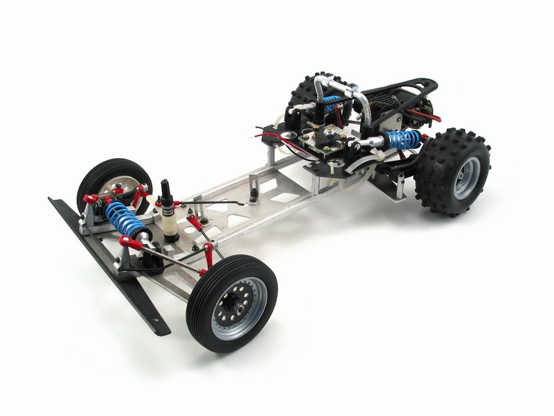

I've been asking this for quite a while and hopefully some good soul would help me so that i can restore my AYK Bobcat/Buffalo kit. I have here an image of the model for reference and i will just upload the image of the said buggy once i get back.
The parts i need help with are as follows:
body shell : I have searched high and low in e-bay but cannot find one. could you suggest any third party alternative? there is 'AYK Radiant' but im not sure if this will fit without the need for modification.
pinion : I have the original spur gear, so what pinion pitch should would be compatible with it?
bumper : could you suggest alternative
wheels : i need the front and back, where may i get those, or an alternative?

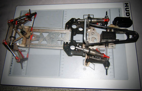

as promised here is the actual condition of my AYK
i hope people here will help/guide me to build this buggy

You got yourself a nice car. Unfortunately there are no reproduction shells for the bobcat, boxer and buffalo that all use that chassis... So there are not so many options but using a different shell. I'm not sure the Radian shell fit so well on that chassis although it looks like the buffalo...
For the pinions I think they are the same type as Tamiya ones so there should be no problems there. For the wheels and tires you will need to try different options until you find one that works. I also want to mount modern wheels and tire on mine but I haven't spent time on that project yet. For the bumper, they don't really show up on ebay... I think CRP use to have a copy for a while though.

I'd try replacing the rear axles with kose's TLT extended axles. That's what I did on this car: http://www.rc10talk.com/viewtopic.php?f=48&t=5973&p=106153
Once you got those you can put a 12mm hex and about any wheel that uses those.
For the front you could use ultima wheels, some shumachers, even some old rC10 ones: anything that fits a 8x4mm bearing
(8mm bearings fit imperial 1/3" bearing spaces)

as mentioned, i started dis-assembling the kit for cleaning and make it run

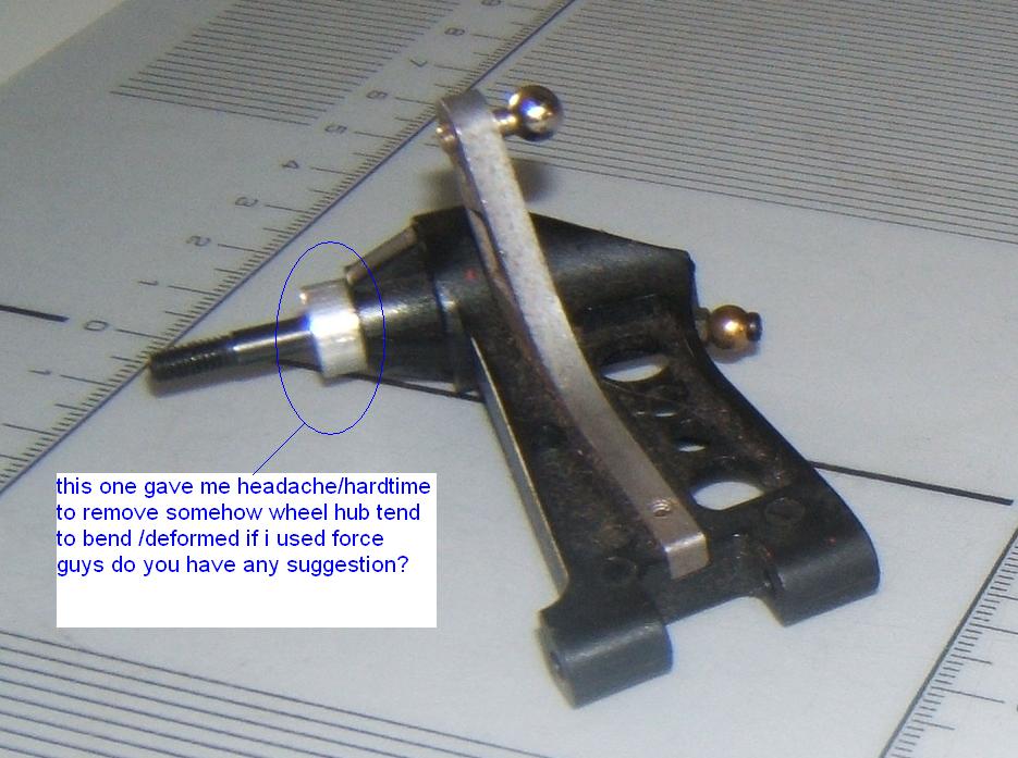

so far i encountered only one problem that is 'removing the wheel hub '

You can use a small hammer and tap firmly on the screw side of the shaft... It is just a pressure fit.

Mr. ED wrote:I use a pair of siccors (spelling correct?) for such things
AYKBOBCAT wrote:You can use a small hammer and tap firmly on the screw side of the shaft... It is just a pressure fit.
hi guys, thanks for the tips. I will surely try that

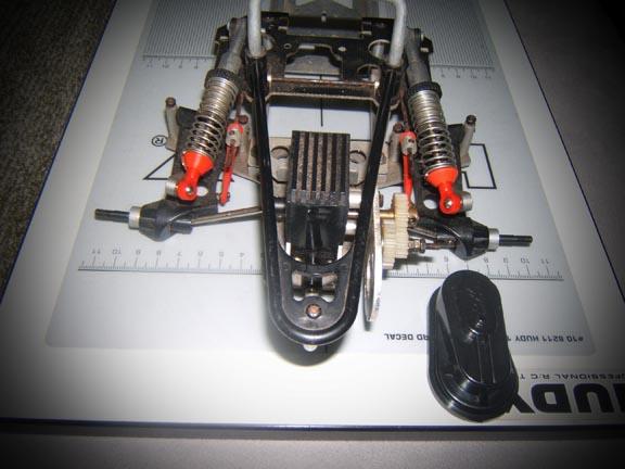

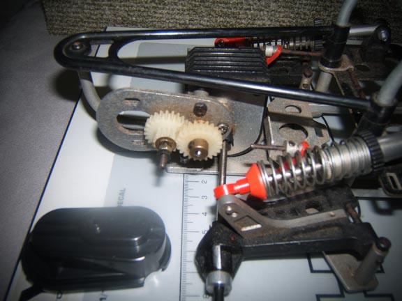

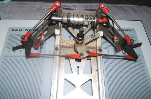

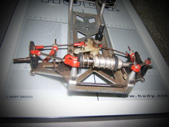

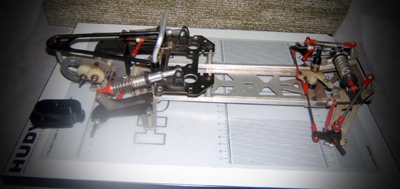

last weekend i have managed to re build the differential gear and applied grease in to it. and also rebuild the shocks and put new oil.
the hardest part was to removed all those stubborn rust. after cleaning my thumb and pointer finger were all numbed and swollen.
but quite happy after seeing the result

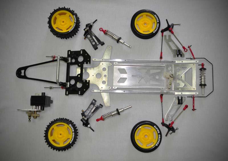

here's one of the exploded picture of my re-born buggy
till next week and happy racing to all

Did you manage to get those wheel hubs apart?ireg wrote:as mentioned, i started dis-assembling the kit for cleaning and make it run
