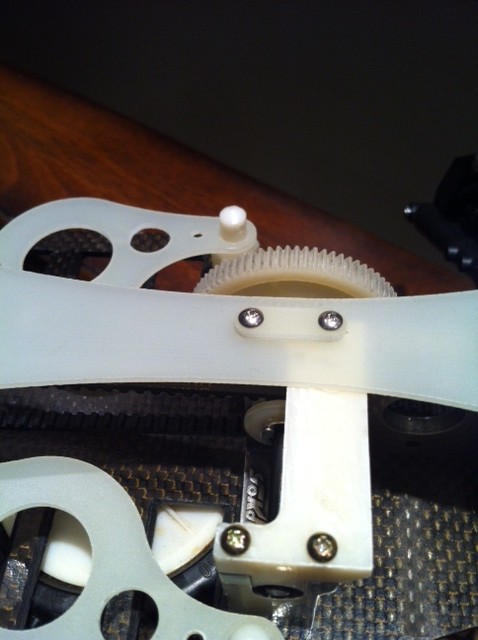

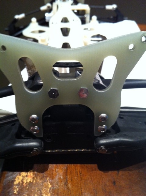

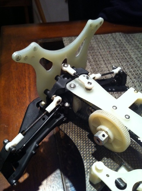

Finally managed to sneak away some time during the holidays to mount some of the white bits and am pretty happy with how it all turned out. Definitely not a complete shelf queen but looks pretty darn good from a foot or two away

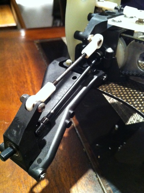

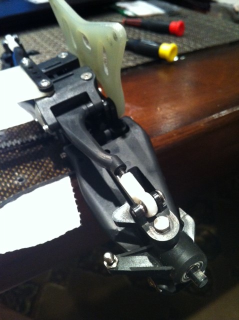

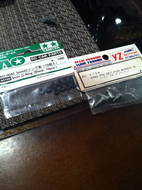

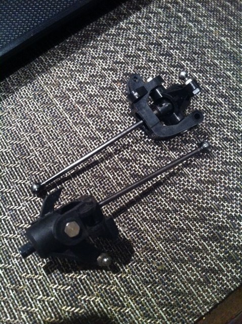

Managed to make a little more headway with respect to the front suspension, assembling the hubs, axls etc. and finally getting those 3mm rubber o rings in the mail so I could finish mounting the king pins on the front shock tower. Getting so close I can almost taste it lol.

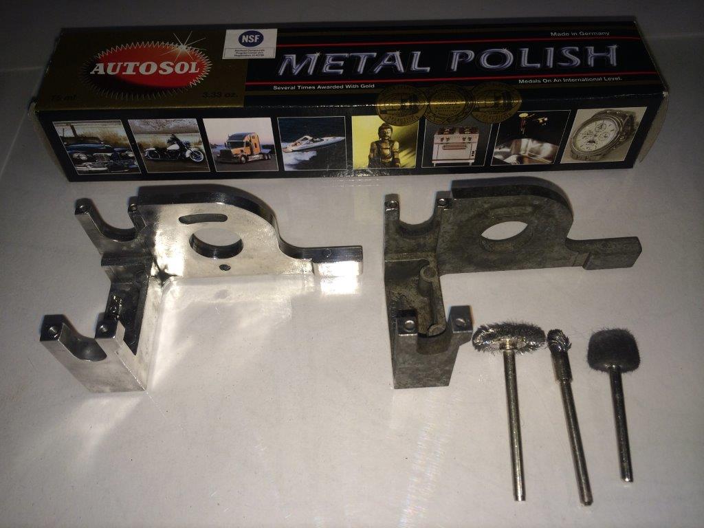

Ok will post some pics when i get back from hols...so sit tight! I will show you what attachments i use. Doesnt seem to take off any of the magnesium just the gunk. If its feally pitted ofcourse there isnt much you can do unless you want to take layer of mag off. Also i am careful around the bearing seats etc i dont go too hard.
Give me a week or so and i will put some pics up. They will be straight from the dremel and without any extra polishing which i am sure you can do with a standard mag polish like the old days. Anyway they do shine like they did in the manual.

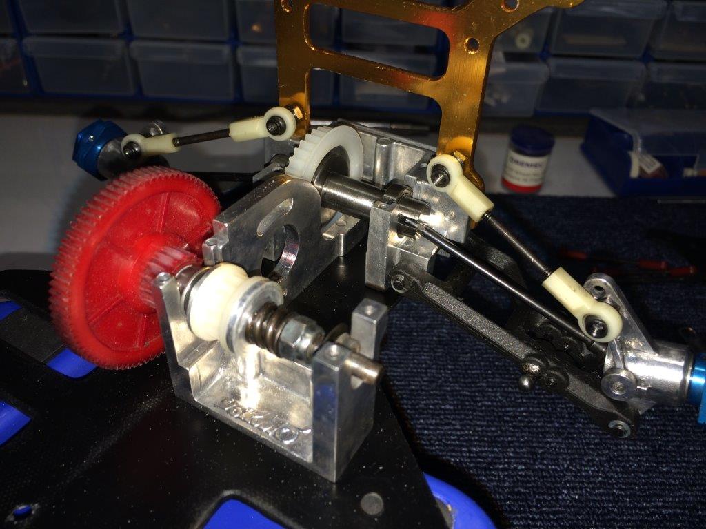

Hey mate here is an example of the dremel at work to clean up your magnesium or alloy bits...plus a bit of a buff at the end to make it all shiny like the use to come straight out of the box..!
and in my 'bitser' 91 wanna bee...but not quite...

If You wan´t the magnesium to look out of the box new, You can blast it with glassbeads.
I´ve never seen Yokomo magnesium parts being glossy/shiney/mirrorish out of the bag/box
Don´t worry, I´ve got a mirrorpolished motormount myself

That mag looks great.. I would suggest shooting some clear on it otherwise it will tarnish unless you polish it regularly.. just the nature of magnesium.. had a friend that polished up some mag wheels and they tarnishied in a few weeks.. it was on a datsun 510 though that he drove.. either way the mag parts look great!
Shawn
oh and fyi, even my NIP motor mount is tarnished.. I haven't even opened it yet..
Shawn

Cool i have some clear and will pull it apart and give it a spray
In the mNuals i have all the mag parts look shiny and new like this so i thought i'd polish them up the same. I use to have mag wheels on an old hotted up cortina so yep i use to polish them, and yeah they would fade again but i thought that was the nature of the beast,,but yeah i think i will put clear on these as polishing is a little tricky.

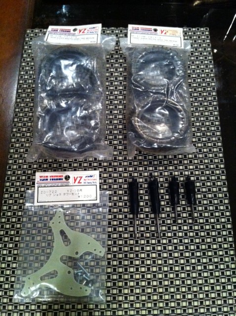

Well like everyone else, some things got in the way and the project was partially shelved but thankfully I received some goodies in the mail that allows me take another small step forward.
Finally, finally managed to get my hands on what I believe to be the proper box tires, TR-31 s for the rear and TF-310 s for the front.
The shocks I had were pretty worn so I decided to bite the bullet and stumbled across a decent replacement set on ePay, not mint but in a heck of a lot better condition than the ones I had.
The rear shock mount was used and although looked to be in pretty good shape there was a considerable sized mark/damage in the lower half that was just bugging me for some strange reason so a quick overpayment later and tada!!!!! lol
Can't wait to start putting these together, I am so close I can almost taste it...ermmm see it More and better quality pictures coming soon.
