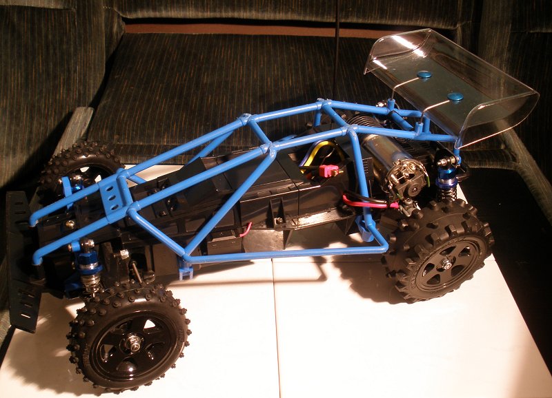

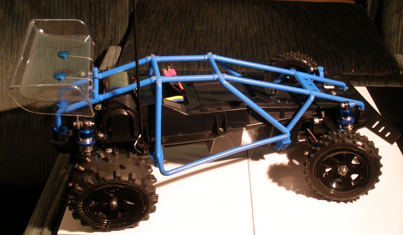

I picked up a new wing to replace the messed-up original undersized wing (the lexan stand-offs were previously ripped out and it was just bolted directly onto the plastic rollcage standoffs at the rear). I drilled straight through the plastic rollcage standoffs and made a U-shaped wing mount from piano wire, then installed wing buttons & the wing. Now it should be more forgiving with roll-overs and also adjustable.
I slapped on the upper covers & rollcage to take a pic, this is pretty much what she'll look like when finished.

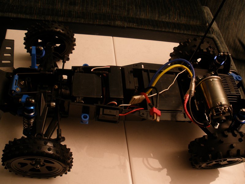

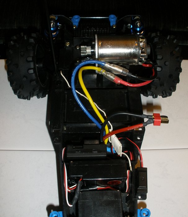

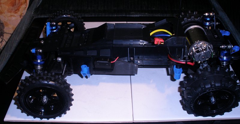

Electronics & new covers installed
Post by Coelacanth »
Finally able to make some progress on the Galaxy, and it's almost finished! Thanks to bigjeepzz, I received a brand new ESC from a re-re Tamiya Grasshopper. Did some soldering, added a Deans connector and had to retro-fit an old male Futaba connector in place of the ESC's more modern female connector, so that the ESC would plug into the old original receiver. Tucked the electronics into new positions, moving the receiver and ESC each one bathtub "compartment" forward, as I feel this might improve weight distribution. The Galaxy is overly butt-heavy IMO.
I buttoned everything up with a set of new plastic covers and I must say, this Galaxy is looking a lot tighter than it did back in the ol' days! :)

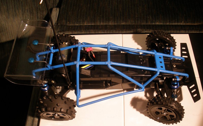

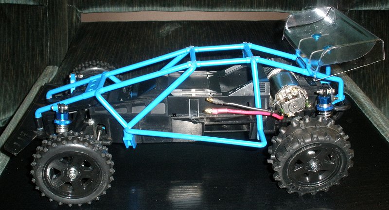

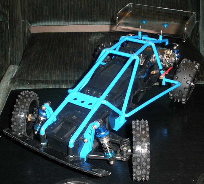

Rollcage Installed
Pics with the rollcage and wing installed...all that's left to do is paint the wing & test/calibrate the electronics. Unfortunately there's about 2 feet of snow on the ground, I have no idea where I'll be able to do some proper test-drives...but eventually I'll update this thread with a video. 8)
