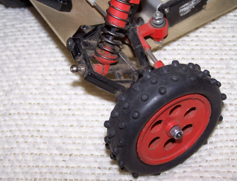

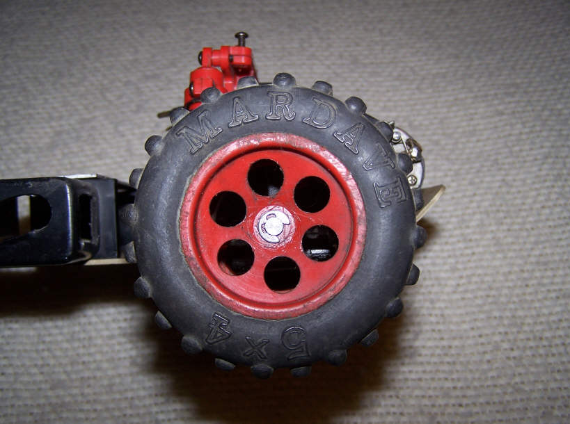

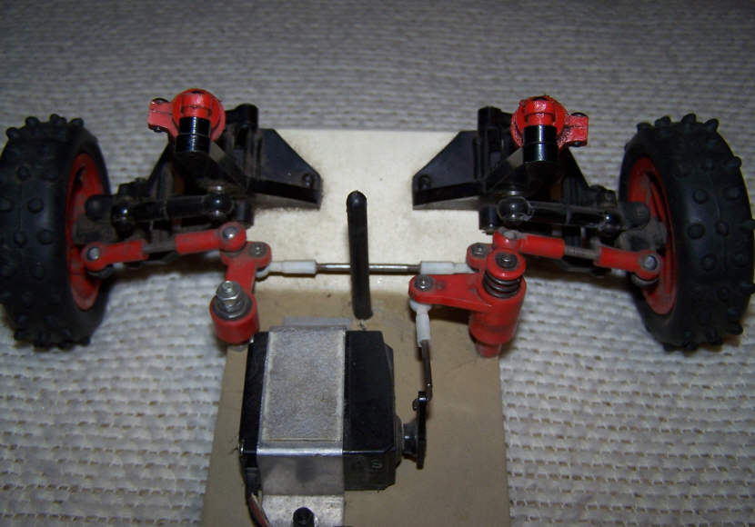

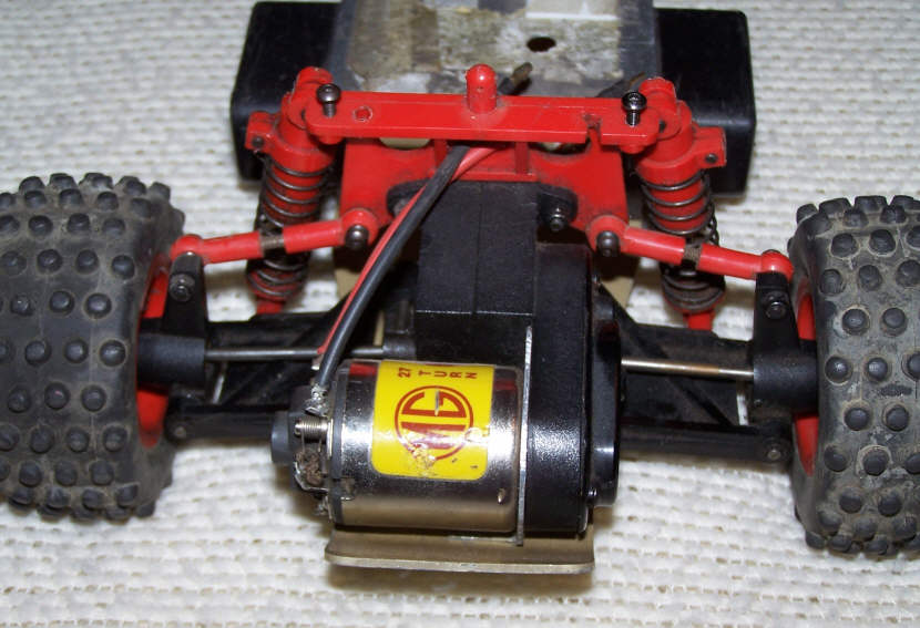

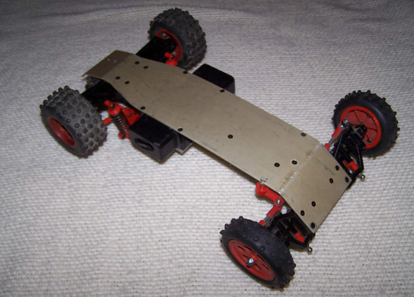

I picked up this Mardave Meteor recently in order to complete my 2wd collection. I knew about Mardave from a UK RC mag that I picked up in 88, but I really didn’t know too much about them. I recently did some research and I think the car that fits in to the RC10/Jrx2/Ultima era was the Meteor. If anyone has more info on the company or car, I’d greatly appreciate if you can bless me with your wisdom.
I began looking and found this one a few weeks ago. I’m happy with the overall condition of the car…but what sold me was that it came with a new body, wing and driver.
I know I’ll need the following items...and hopefully they won't be to hard to find.
Red rod ends (6)
Red front body post
Rear antenna mount
Battery cup (I may try to fix the holes)
Mechanical speed controller (red version…there’s also a black one)
Here are some pictures of the car:

Yours has an upgrade gold annodised long wheel base chassis. Just check that the bodyshell actually fits the length, as the true LWB bodys are hard to find. I think Mardave probably still sell some parts that you need.

Yours has also got a common modification racers did, the metal plate between the motor and gearbox. The Meteor bolted the motor to the plastic gearbox and the kit spur gear had no bearings, so when racing the motor heat would soften the gear case and contributed to destroying the spur gear. A ballraced spur gear and a metal plate bolted to the chassis acts as a heatsink to make the gearbox pretty reliable.

Your car looks to be in good condition & appears to be an earlier car with the 6 hole design wheels & chunky tyres - the very last Meteors came with the 2" one-peice dished wheels (Cobra Wheels were 2.2" but came with the same ISF/ISR tyres), fixed moulded linkages, Mardave also did away with the brass bushed rear hubs (the bushes could be replaced with ball races) so the axles span directly onto the plastic moulding!!
