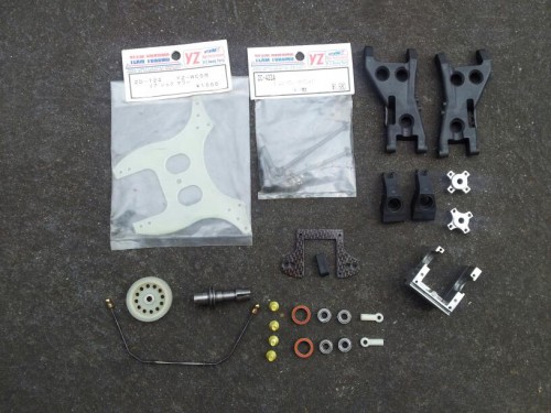

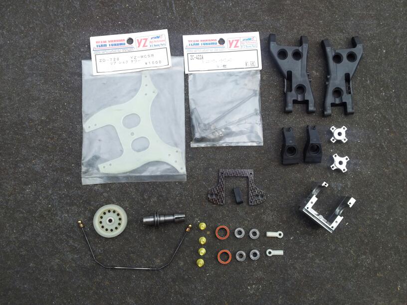

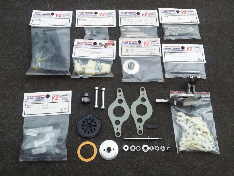

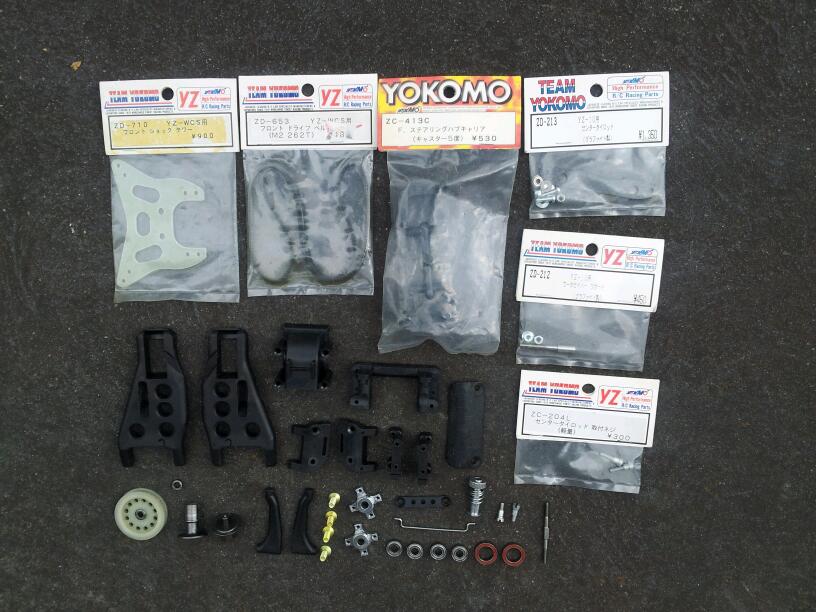

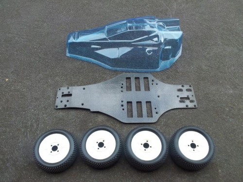

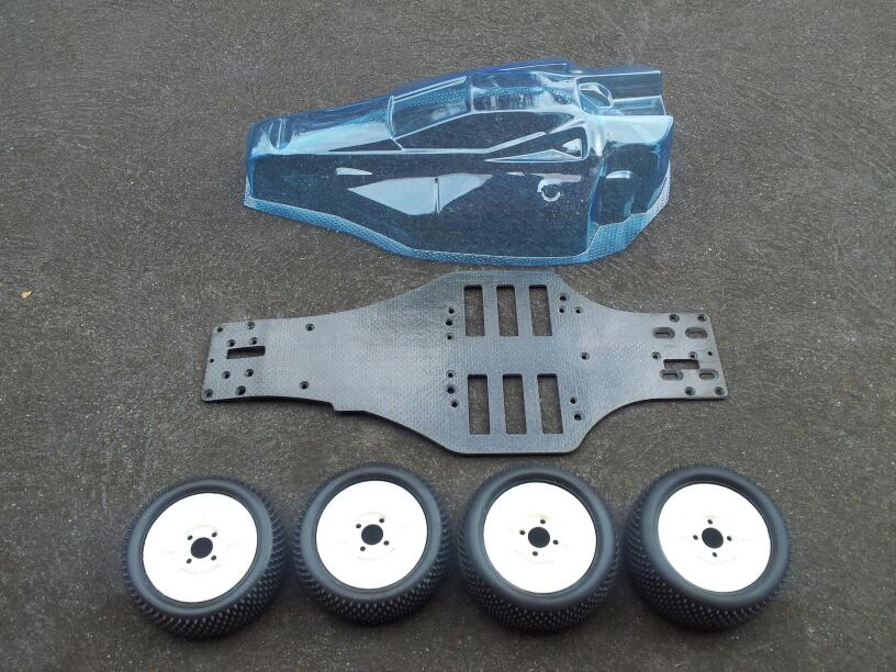

Here's my total progress so far of cleaned and new parts ready to be assembled, slowly chipping away at it. Sadly someone else bought the .71 AE shocks so that's something else I have to track down.
I still have a few bits in transit like rear belt, white steering bellcranks and front upper turnbuckles.

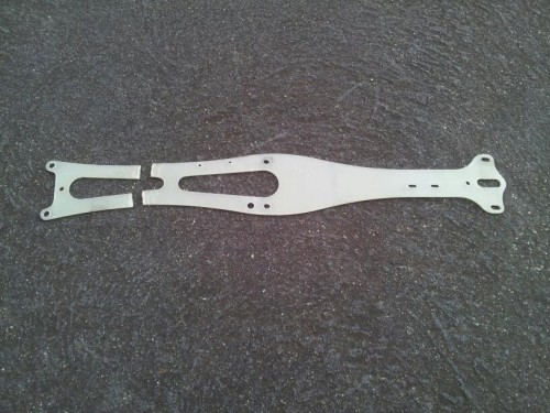

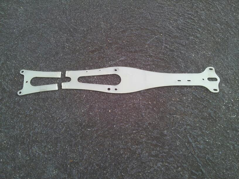

My poor top deck is broken Masami style. I managed to break off the "patch" which came off rather clean. I think this is going to be one of the hardest parts to find, unless I can find a fiberglass sheet that has an OEM appearance.

Mr. ED
Posts: 5477
Has thanked: 58 times
Been thanked: 56 times
Re: YZ-10 for dummies? - 93' WCS
Post by Mr. ED »
RC10th wrote:My poor top deck is broken Masami style. I managed to break off the "patch" which came off rather clean. I think this is going to be one of the hardest parts to find, unless I can find a fiberglass sheet that has an OEM appearance.
mmm, didn't masami use a shock damper on top of these :wink:
pedro
Posts: 239
Joined: Thu Jun 12, 2008 4:24 am
Been thanked: 76 times
Post by pedro »
Hi there
When I did mine the only stuff I could find had a glossy finish but could easily be dulled up with a scotch bright pad just practise on an off cut but mine came up pretty good.
peter
