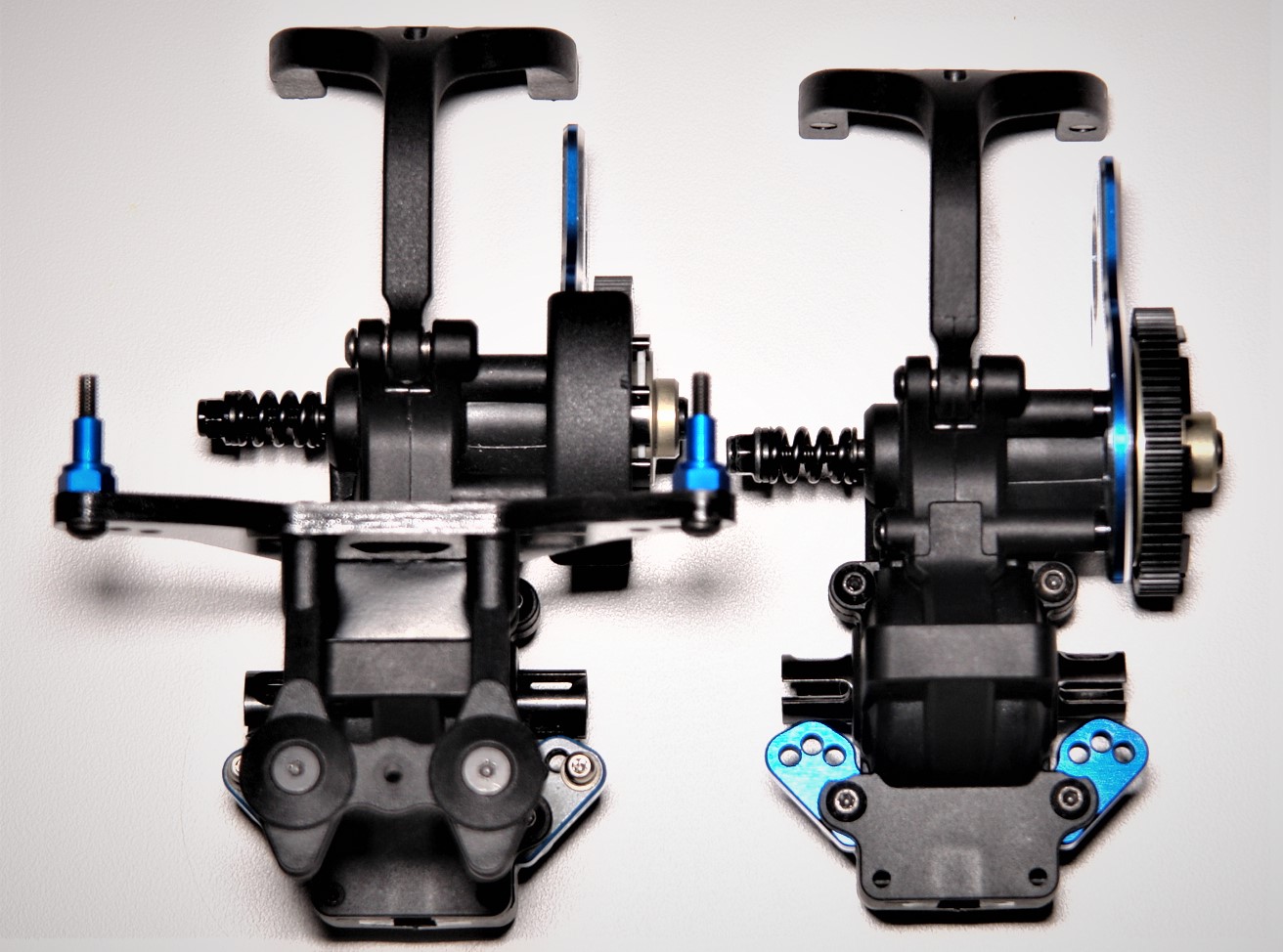

Hey, could you please post a photo that shows the difference; "laydown" vs. "layback" - for us ole-timers who are unfamiliar with modern RC buggys? By chance do either of those configurations include two idlers?
I've also noticed oval drive cup bearing holes - I'm guessing this allows for optional mounting locations hi or low?

No need for sorries! You just put another idea in my head. New home for the layback. More on that later.
Though I'm sure not an authority, here is my take on the differences.
The layback offers a slightly shorter overall transmission length. The layback uses a smaller idler and it looks to be slightly lower. Both are 3 gear configs.
The layback shifts the center of gravity back by moving the motor rearwards. Overall it moves the motor and possibly battery back about 8mm.
More rear traction for looser dirt tracks they say.
The laydown is probably better for carpet and very high traction surfaces.
Preminarily total weight of my car is well below ROAR so adding weight at the rear is a definate possibility.
Both trans share the quick access diff. Both trans can use either gear or ball diffs
Both trans have adjustable diff heights like you mentioned, 3 different heights in all.
I chose the lowest position to most closely approximate a 3 or 6 gear outdrive height.
The outdrives are also deeper than the 3 or 6 gear. The ball diff offers almost 2mm additional per side, the gear diff offers slightly less.
The additional depth should be welcome if using the B4/B44 carriers and axels like I intend on doing.

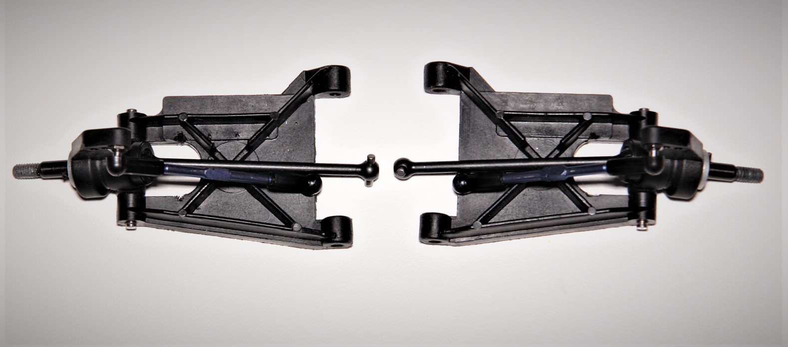

B4/B44 hub carrier and axels. The 9608 blue aluminum spacers are unobtanium so some plain aluminum washers that I had will work just fine.
Associated FT blue titanium turnbuckles. Bought several sets when on sale a while ago. Not exactly the correct length but they will be fine also.

Started mocking up rear suspension.
